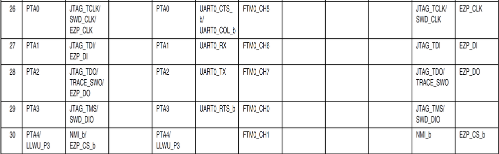

these are the possible options fot the JTAG pins:
do you think I should configure them as GPIO inputs before entering LLS?

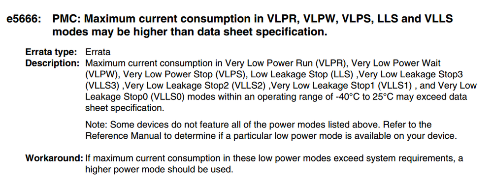

Please check the MK11DN512AVLK5  chip mask set at chip surface second print line.
There is an errata file for mask set 0N89E chip with below errata info:
Wish it helps.

This errata does not apply to my MCU as the mask written on it is 0N62J.
Even if the power consumption is higher then what is stated in the datasheet, I don't think it explains the difference between starting the application from IAR (in this case the SRS register states it is a SW reset) and starting it using POR
