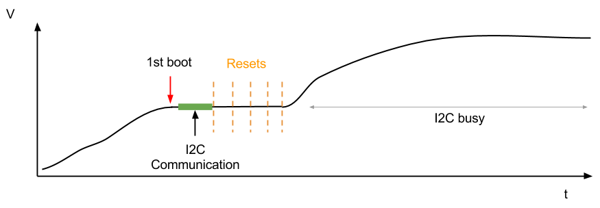

I have an issue with the I2C module.
Context:
µC K10 is the Master, linked to only one slave.
I configured the Power Management Controller to reset on a Low Voltage Detect (PMC_LVDSC1[LVDRE]).
This is what happens:
When the tension rises slowly, the µC boots, then the I2C communication starts but it is stopped by the hardware reset (due to the Low Voltage Detect).
Then, when the tension is high enough, the I2C is locked in a busy mode.

Hi Dilebo:
What do you mean exactly with busy?
Do you mean the status bit I2Cx_S[BUSY] stays at 1? or that the SCL line is held low?
These are different situations. In the first case if your K10 is the master, then the code you posted should take you out of the busy state once you call i2c_stop(). In the second case, if some of the slaves holds the line, then this is a hardware problem. Or it could be a combination of both, your K10 master trying to send stop signal and the slave holding down either of SDA or SCL bus lines.
Sorry If I did not understand well your situation.
Regards!
Jorge Gonzalez

Dilebo
Hello Jorge Gonzalez,
Thank you for your answer.
Yes I was talking about the I2Cx_S[BUSY] bit.
I mixed the two solutions from my first post and came up with the following :

This is working.
And if it can help anyone, I found this application note : http://cache.freescale.com/files/microcontrollers/doc/app_note/AN4803.pdf?fpsp=1&WT_TYPE=Application...
With a tI2C_fault I2C_Restore(void)  function. But I didn't try it.
It is roughly the same thing as my solution, but driving the signals SCL/SDA in GPIO mode.
