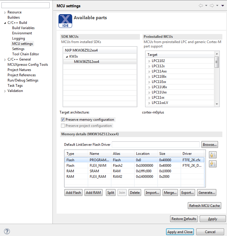

Actually, do I need to follow step 1 and 2 if I am using only the KW36 micro (custom board), not the FRDM-KW36 board?
In my custom board, I don't have the OpenSDA programming option (programming through USB).
I tried step 3, 4 and 5 also. The data in the DFlash is not getting updated.
Do I need to make any changes in Project --> Properties --> C/C++ Build --> MCU Settings --> Memory details
Please find the below image.
I tried flashing the .axf file using JLink Flash V6.47a software, but it is not working.
Please check and let me know.

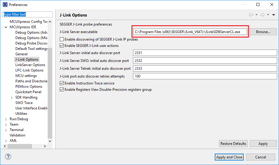

Hi Naven Suresh‌,
As you supposed, if you are using an external J-Link probe, you don't have to update the OpenSDA firmware.
I forgot to mention that you have to install the J-Link Software. Go to your downloads folder and search the J-Link Windows installer (or your OS version). When customizing the installation, select the option below and remember the path (this is to ensure that you are using the correct J-Link version, a new folder will be created in your PC instead of only update the existing location with the new files).
Then, update the J-Link executable path in MCUXpresso IDE, using the destination folder created in the installation process. You only have to provide the new path for the JLinkGDBServerCL executable, there's no need to modify the other parameters in the J-Link Options window.
I'm sorry for the inconveniences.

nsuresh2
Hi nxf46726,
Thanks for the update and support!
It seems like the issue is resolved. I could able to update the FlexNVM also.

hagguisouhail
Hi Kerry,
Thank you for your quick response, maybe the thread I posted concerns the LPCXpresso IDE, however it contains the same steps as the thread you posted to me. The problem in fact came from the use of the FlexNVM as a PFlash. Thus when I add a section in the MCU setting that points to the FlexNVM region (@ 0x10000000 and LENGTH = 0x20000, alias Flash2), next using the cr_section_macros header file I define some data to be stored in this new region using __RODATA(Flash2). Everything seems to be OK until debugging, since i found that there is no data stored in the FlexNVM memory (it contains only 0xFFFFFFFF). My question, am I in need to specify a flash driver for the FlexNVM memory, as for the Pflash ? Moreover, am I in need to set the Flash Configuration block  ?
