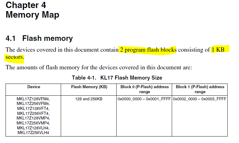

Can anyone point me to where I may find information about the Flash block and sector sizes on the MKL17Z256VLH4?
