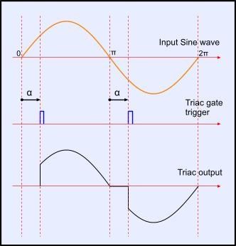

I need to command a Triac with a specific delay after the Zero detection to adjust output power:
To do this, I have a hardware which generate a pulse when signal is 0.
Then from this time, I must generate a pulse a (configurable) time after.
My first Idea was:
ZeroDetection pulse connected to an GPIO which generate an interrupt on the edge. In this interrupt, I get the FTM counter and Set CnV and Cn+1V (Combine mode) to generate a pulse of certain time in a controlled delay:
CnV = Current FTM + Delay
Cn+1V = Current FTM + Delay + Pulse wide
Generate IT on Cn1V compare to disable Output (ElsnA, ElsnB = 0)
Bad: Delay between input rise and Get FTM counter (due to interrupt save context time)

Are they a way to generate a pulse (with configurable wide) a certain time (configurable) after an input rise without any software intervention (except in initialization time)?

I have checked the FTM module, I know that ONLY RISING edge of hardware triggering signal can trigger FTM to start counting, the falling edge of hardware triggering signal can not trigger FTM to start counting. I suppose you hope that the tri-ac works in both positive and negative cycles, in other words, one AC cycle can trigger FTM twice, so the FTM hardware triggering solution is NOT feasible.
Regarding your two solution, I think both solution are okay, both GPIO interrupt source and capture interrupt source supports rising/falling edge to trigger interrupt. In the ISR, you can initialize the FTM_CNT to zero by writting the FTM_CNT register directly, if you set up the FTM channel in COMBINED mode, you can set up the FTM_CnV register and FTM_Cn+1V register to control both the delay and width of the tri-ac gate signal, you can set up the FTM_MOD as maximum so that the PWM signal only generate one cycle.
The solution based on an4608 is okay.

Yes I want work in both positive and negative cycle.
But it is possible to obtain a positive edge on each by design an hardware zero crossing detection which provide positive edge on both. This is not a problem for me.
So you seem say that it is possible to triggering start counter by  directly by hardware, without software. How do  it?
