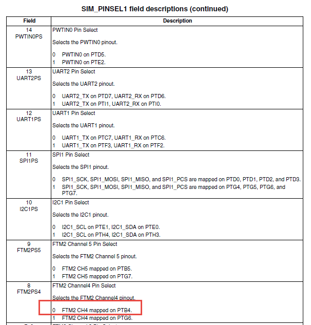

The problem is that PWM signal is perfect but PTB4 interrupt not works.
PTB4 interrupt only works if I don't setup PTC4 PWM, as if there was a problem with the signal multiplexing of the PTB4 pin because I see also on PTB4 the PWM signal!
How can I setup these pins to works together but with different roles?
Anyone can help me?

Hi Danniele Mereu,
      Did you do some modifications in your FTM_PWMInit(FTM2, FTM_PWMMODE_EDGEALLIGNED, FTM_PWM_HIGHTRUEPULSE);?
      If you are not modify it, your test result is correct. Because in the FTM_PWMInit(FTM2, FTM_PWMMODE_EDGEALLIGNED, FTM_PWM_HIGHTRUEPULSE); This function enable all the FTM2 channel, and PTB4 is also the FTM2 channel4,  from the RM document:
FTM2_CH3 is defaultly mapped on PTB4, then your KBI function won't working, because KBI function priority is lower than FTM.
If you want the KBI working, you should disable the FTM2_CH2.
Wish it helps you!
If you still have question, please contact me!
Jingjing

danielemereu
Hi Jingjing
perfect, thank you for your answer.
Inside the routine FTM_PWMInit I've done this change:
if(FTM_PWM_HIGHTRUEPULSE == u8PWMEdgeSelect)
        /* Configure timers PWM High True Pulses */
        for(i=0; i<channels; i++)
            if( i != 4)     //     with this instruction I've excluded the channel 4 from FTM init as PWM
                pFTM->CONTROLS[i].CnSC = FTM_CnSC_MSB_MASK | FTM_CnSC_ELSB_MASK;
                pFTM->CONTROLS[i].CnV  = FTM_C0V_INIT + i*100;
Now on PTB4 I don't see the PWM signal, finally!

Hi Daniele
The port multiplexing in the KE works based on peripherals that are enabled and their priorities.
The keyboard inputs have lowest priority and so when on PTB4 both KBI1_P6 and FTM2_CH4 are enabled, FTM2_CH4 will have priority and drive the output.
This suggests that your PWM routine is enabling the PWM output on both PTC4 (FTM2_CH2) and FTM2_CH4. You can check whether this is the case by looking at the FTM_CSC_ELSA  and  FTM_CSC_ELSB bits in FTM2_C4SC.
Mark
