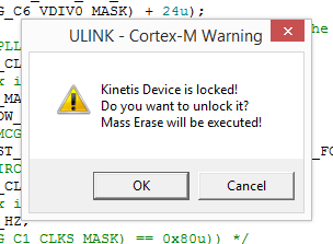

I am using MKL16Z256VLH4 controller, when trying to download code ,getting message " Kinetis device is locked ! Do you want to unlock it ? Mass erase will be executed ! ". see below
 Clicking OK or Cancel displays message: " Cannot access memory".

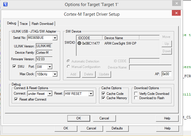

I have tried it in keil with ULINK-ME

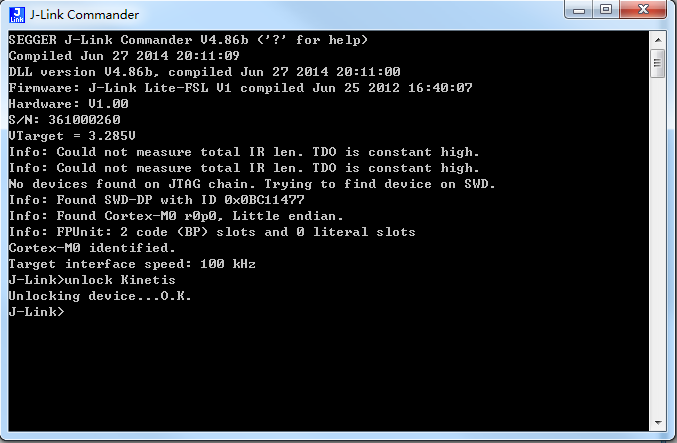

Do you have a Segger J-Link tool on hand?
If yes, I would recommend to download and use Segger J-Link Commander tool to unlock KL16 chip.
Wish it helps.

I don't have J-Link tool, I'm using Ulink2/ME..how to unlock with this tool

Hui_Ma
Hi Durgesh,
Please check below link if that could help to fix the issue:
ULINK: UNLOCKING FREESCALE KINETIS MEMORY WITH ULINK
Wish it help.
