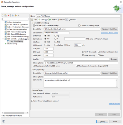

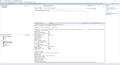

I need help troubleshooting a debugging issue with using the J-Link Ultra+ emulator/probe.  I have created a KDS project within the Kinetis Design Studio redirecting output from the console component to a UART. I have compiled it and selected the Debug Configurations -> GDB SEGGER J-Link Debugging configuration. It appears the values are filled in correctly with the device name being MK60FN1M0XXX12. When I launch the debugger I receive the error in final launch sequence "Failed to execute MI command: -exec-run" Error message from debugger back end.  If I use the ozone debugger (SEGGER's debugger for the J-Link probe), I can flash and run the elf file fine.  I would like not to use the separate Ozone debugger and concatenate my development activities to a single IDE for this MCU.

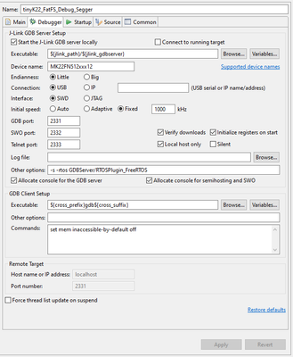

Can you share a screenshot of your settings?
It should look similar to this one which uses the K22FN512:
Your message indicates that it is not able to launch the GDB server. The default config uses
${jlink_path}/${jlink_gdbserver}
so check the following:
and check if the path and file exists.
I hope this helps,
Erich

This is my console output:
SEGGER J-Link GDB Server V5.10n - Terminal output channel
Connection closed by the GDB server.
-larry
12,814件の閲覧回数
MCU_Larry
SEGGER J-Link GDB Server V7.70 - Terminal output channel
I updated and still get this error.

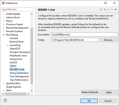

I don't think this is your primary issue, but your J-Link version is very old. The current on is around v7.66.
I recommend that you update the J-Link installation in any case.
12,827件の閲覧回数

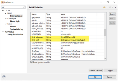

MCU_Larry
I don't have the SEGGER J-Link selection under Windows > Preferences > Run/Debug.  I did add the build variables to the Preferences > C/C++ > Build > Build Variables as you have them defined here.
-larry
12,821件の閲覧回数
ErichStyger
Specialist I
I still think you have your executable of the J-Link GDB server somehow wrong.
Maybe instead using variables in the launch config, point directly to the executable.
Your console view should look similar to this:

You get that console view if you select it from the drop-down:

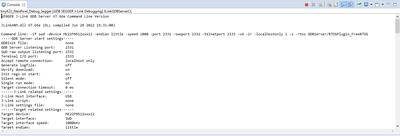

MCU_Larry
ErichStyger,
  Thank you for that tip. Here is my KDS console view of the JLinkGDBServerCL.  Things look good in this view.  However I still cannot connect to the GDB server.
12,761件の閲覧回数
ErichStyger
Specialist I
Yes, everything looks good, except it should connect like this:
>>Waiting for GDB connection...Connected to 127.0.0.1
Do you have maybe the connection blocked by some firewall or similar?

That's a good question. However, I am connected to the J-Link Ultra + over USB. I take it the debug configuration tries and runs the J-Link GDB server locally on the windows machine and then tries to connect with GDB over TCP/IP? I added the JLinkGDBServerCL.exe and the kinetis-design-studio.exe to the firewall and the debug session behaves the same.  Is there another app I need to add to allow through the firewall for loopback access?
12,800件の閲覧回数

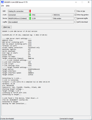

MCU_Larry
I have modified my Debug Configuration to point directly to C:\Program Files\SEGGER\JLink\JLinkGDBServerCL.exe. I am not sure how you generated the console view from the KDS. That may be my issue.
I ran the JLinkGDBServer.exe directly and am able to launch the GDB Server task.  Attached is my window from that run.
12,783件の閲覧回数
ErichStyger
Specialist I
your settings show JTAG. Are you sure you don't want to use SWD?
12,780件の閲覧回数
MCU_Larry
I am connected to the SOM with a JTAG 10 pin connector.  What is the SWD connector?
12,774件の閲覧回数
ErichStyger
Specialist I
It is the same connector. SWD is just a different protocol (and the default) and requires less pins. Kinetis usually use SWD, unless you mux and use the additional JTAG pins.
