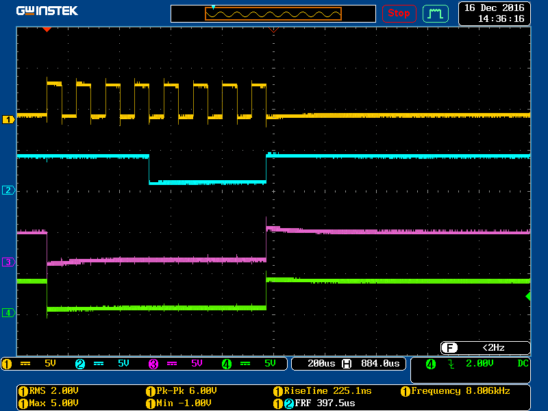

I am using K20 series controller. In slave mode the controller keeps sending the first value that has been pushed through PUSHR_SLAVE. It never updates.
The slave is receiving data correctly which can be seen through the oscilloscope. The settings CPHA and CPOL also match in slave and master
Images of Oscilloscope
1. Yellow (Clk)
2. Blue    (Slave Out)
3. Purple (Master Out)
4. Green (Chip Select)

Problem solved.
It was a hardware problem. cs pin was not correctly attached
