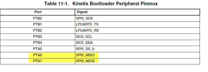

I am trying to use the Kinetis ROM Bootloader via SPI but don't seem to find the pin muxing anywhere in the documentation
I have a FRDM-KL03Z which has a single SPI module but its signals can be muxed to several pin combinations (none of which is the default pin function)

In the KL03 reference manual under the Chapter 11 Kinetis ROM Bootloader you can fin the Kinetis Bootloader Peripheral Pinmux that lists the PTA6 and PTA7 as the SPI pins for the Kinetis Bootloader.
Hope this information can help you

Thanks Adrian!
I must have missed that table somehow... :smileyhappy:
