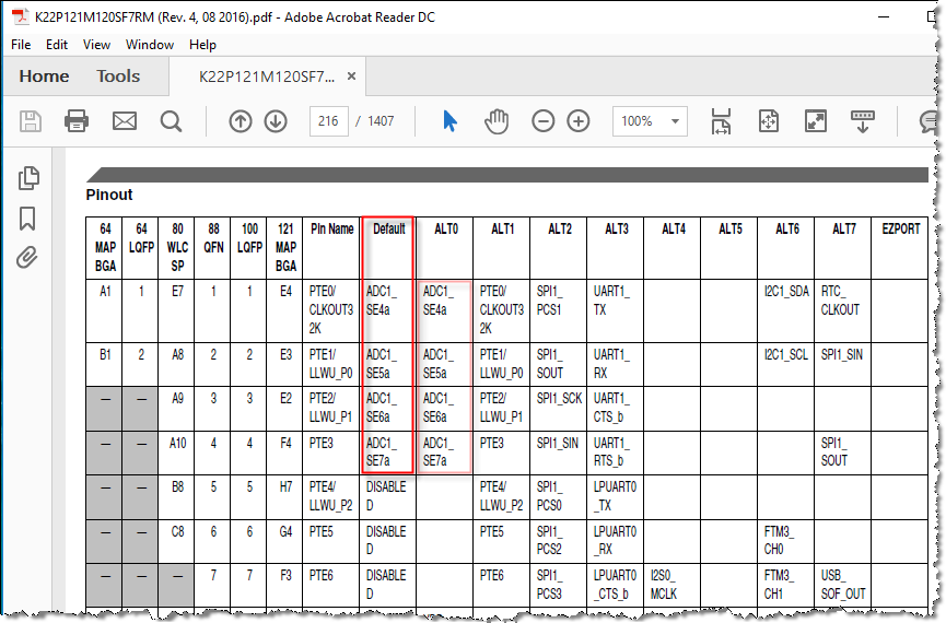

Q1.  should the cpu pins involved ADC device be configured at first during the initialization phase.
A1   The pins with analog functions assigned to them default to their analog function after reset. So you don't need to configure PORTx_PCRn[MUX] select the pin as ADC input function.

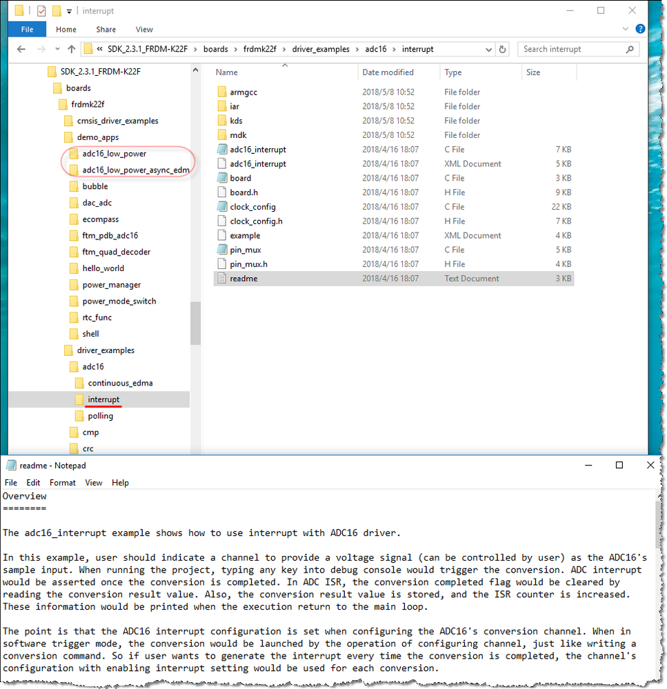

Q2.  there are two modes , query  and interrupt mode to indicate the conversion completion , but when I set the interrupt enable , and start the conversion , however , seems the interrupt is lost, what kind of problem would cause it ?
A2   I agree with Mark. Seems that you forget enable ADC interrupt in NVIC.
I recommend you refer the ADC examples in MCUXpresso SDK.
