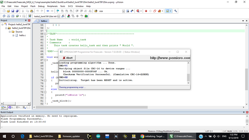

I am programming twr k70 board using keil uvision I am using p&e_micro #osjtag to program. It was programming correctly only but all of a sudden The below screen comes.
Now it is stuck at this screen. If I try to abort the keil closes.
Please Help !
Thanks :smileyhappy:
Vibhu.

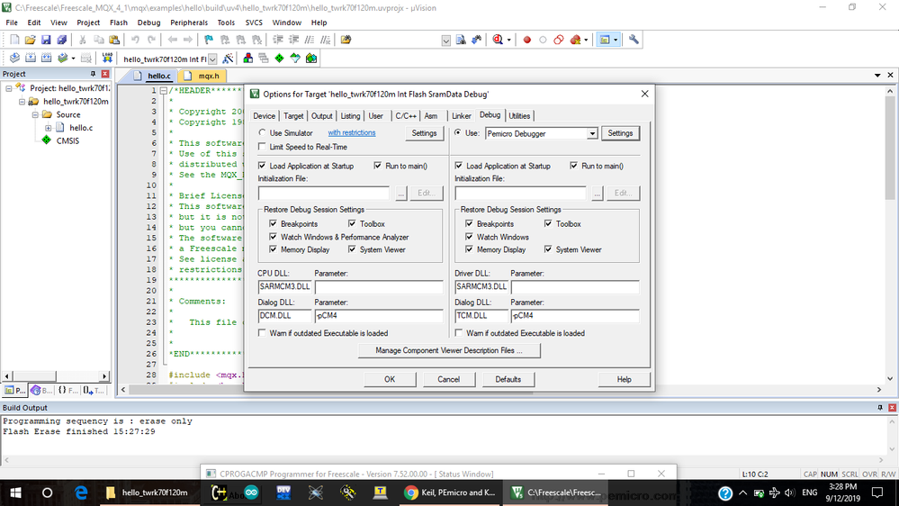

Please tell me the detail.Is the option for debug configured correctly?
I have configured correctly. It was working only suddenly it is not working, I dont know why.

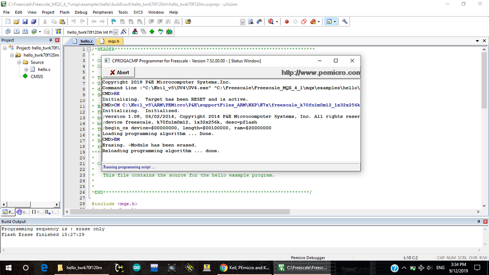

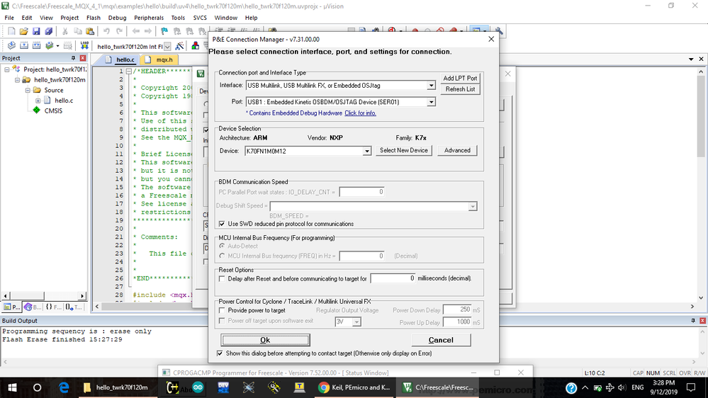

I am using keil to program the twr-k70f120m board. I am using the PROGACMP tool only. When I first installed keil and tried downloading the code to the target it asked me to install the software. After that whenever I give download this PROGACMP comes. It will download the program and it will close by itself. But now it is not closing. It is stuck there when I try to download the code.
When I try to erase the target it gets stuck below
Thanks:smileyhappy:

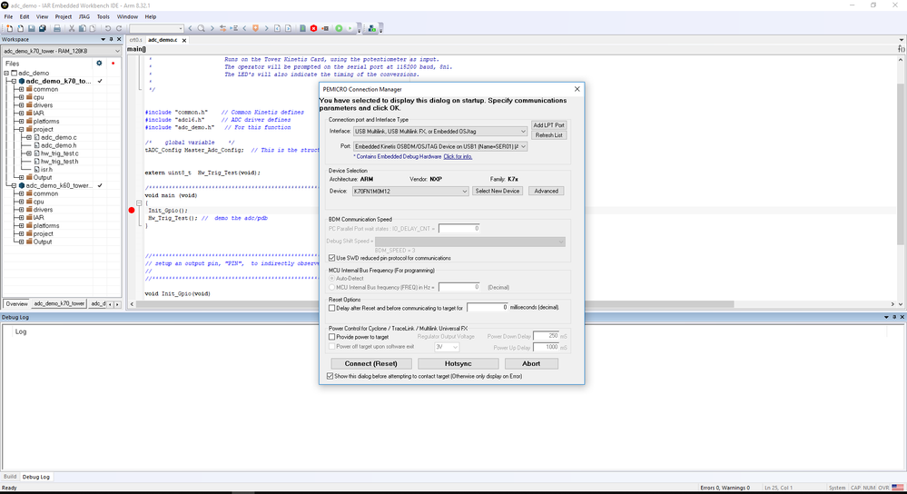

nxf56274
Hi,Vibhu
I used the IAR to test .And it works well.So I suggest you use IAR to download the program.The problem in keil I will go on checking.
