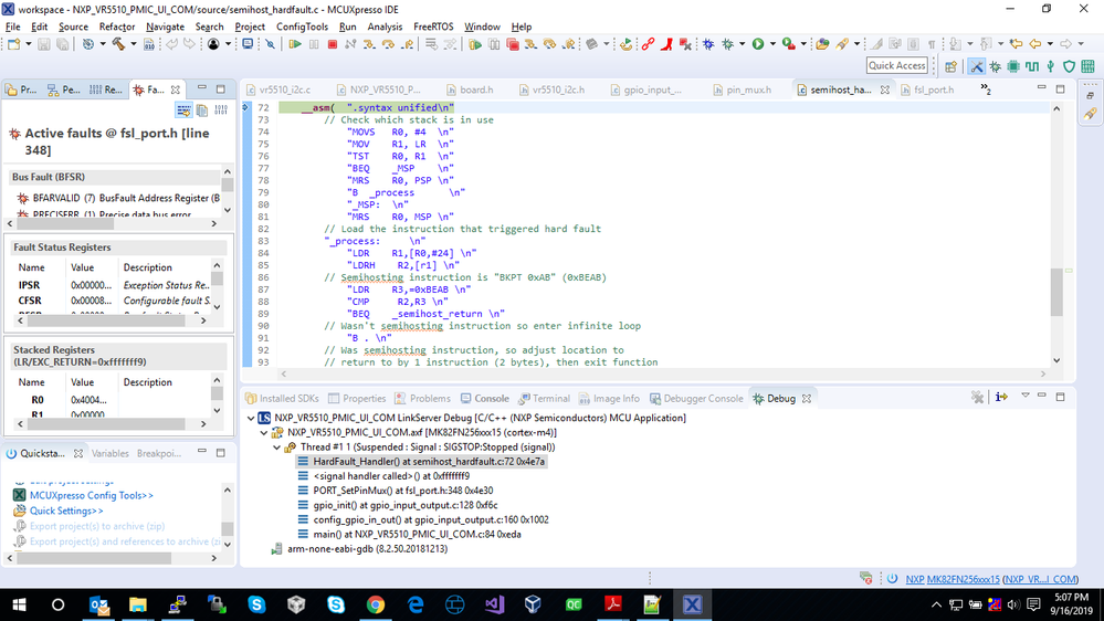

I am configuring few pins as gpios for my K82F FRDM board.
I am able to successfully configure gpios and toggle them for PortA, PortB & PortC, but when I am trying to configure gpios of PortD I am getting error while executing, compilation is happening properly, no errors while compiling
I am getting error as below:

vivek_kaushik
Hi Mark,
Thanks for the input.
Can you please point me to file where this needs to be enabled.
Kind Regards
Vivek
2,464 Views
vivek_kaushik
Hi Mark,
The issue is resolved, I have used below to enable portd clock:
CLOCK_EnableClock(kCLOCK_PortD);
Thanks! for your support.
Kind Regards
Vivek

Most probably you haven't enabled clocks to port D (see SIM_SCGC5)
Mark
