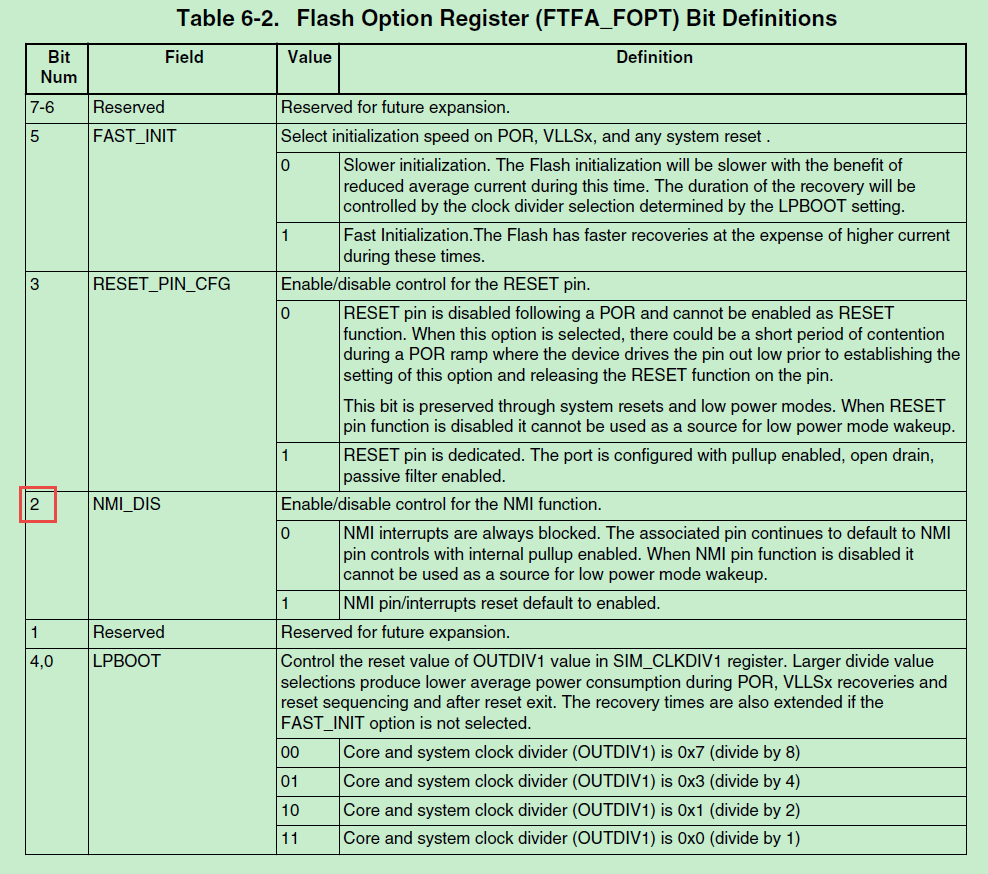

Hi guys, I'm working in a custom board with the KL25Z64. PTA4 (NMI_b) is configured in my application as output with a pulldown resistor. When I run the app without the bootloader everything works fine, but when used in combination with the bootloader, nothing happens.
I reckon Kboot leaves the NMI_DIS (FOPT register) bit enabled by default, thus triggering the interrupt constantly and never running the main application.

Please check blow abstraction from KL25 reference manual:
The NMI_DIS bit is located at FATA_FOPT bit2, that's why customer need to set 0b1011(0xB) to block NMI interrupt.
For the NMI_DIS bit is cleard, the NMI interrupt is blocked, customer does not need to change the pin function if this pin doesn't need be used for another function.
If this pin need be used as GPIO pin, customer need to call related code to set the pin muxing as GPIO function.

After a few cups of coffee and reading this thread I managed to make everything work again by changing my flash config section from my illogical (it seems) ".long 0xFFFFF7FE" to ".long 0xFFFFFBFE". Now I can't help but wonder:
a) I was convinced that the right value was "... F7...". I arrived to this conclusion by analysing the FOPT register of the datasheet:
??=1, FAST_INIT=1, RESET_PIN_CFG=1, NMI_DIS=0, ??=1, LPBOOT=11
So, at the risk of asking something really dumb, can someone please point me out in the right direction (datasheet page # perhaps?) to understand the origins of 0xFFFFFBFE?.

I am having the same issue here and and have followed the instructions listed by Ma Hui, but the problem is not fixed (still getting non maskable interrupt).
I have changed the flash byte values as below to disable the NMI_B bit in the startup_MK22F51212.S.  Using MK22FN512LH12.  Am I doing something wrong here - need to do something more?

Don't forget that the same pin is used to enter the EzPort mode on the K22 - therefore 0xfffffbfe disables NMI but not EzPort. To disable both, 0xfffff9fe can be used.
Furthermore remember that only the boot loader can control this and not the application code, so the change needs to be in the boot loader.
