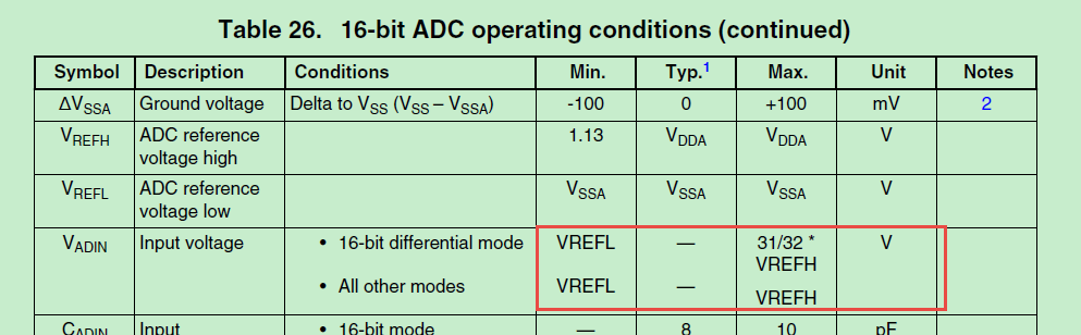

Hi Nicolas Giussani,
    From the datasheet of K22, we can get this information:
  Your VREFH is 2.5V, so you should make sure your adc input is in range[0, 2.42v] in 16-bit differencetial mode, other mode, the input adc voltage should in the range [0,2.5v], otherwise, your adc input pin maybe damaged.
Wish it helps you!
