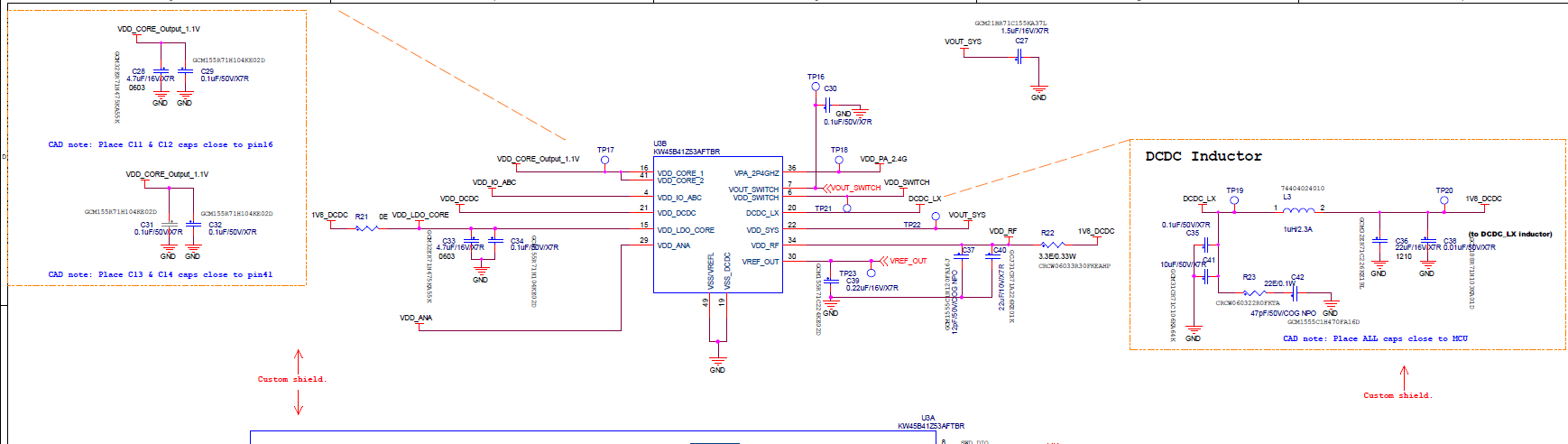

The RTC is retaining its value in the KW45B41Z-EVK during power off when power back up is provided by Coin cell battery, but in i am using KW45B41Z for my project where i am using a super capacitor(25F/3.8V) to power RTC during power off. Here RTC is not retaining its value. So do I need to enable any Low power mode through SPC or is there any special configuration that i should do?
I have also verified the voltage across the super capacitor that is enough to power the RTC during power off. Any low power mode configurations are there for RTC?

kaif1
I am using kw45b41zevk_rtc demo (not rtc_func or power mode switch as in AN14122).
Instead of Coin Cell (as in KW45B41Z EVK) I am using a super capacitor for RTC Power Backup.
During power on RTC will be powered by VDD_SWITCH but during power off, super capacitor will supply power to RTC.
During power off Super capacitor is discharging (tested) but RTC is not retaining its register value.
I have attached the schematics of RTC supply configuration i am using.
Why in the KW45B41Z EVK coin cell backup is given for RTC why there is no rechargeable source like super capacitor or battery?

luis_maravilla
Hello
What values are you getting from voltage across the capacitor? As if goes to a very low voltage (from the capacitor discharging) or approximates to minimal values according to Datasheet, it may cause abnormal functionality such as loss of RTC Functionality: The most immediate consequence is that the RTC will likely stop operating reliably. The timekeeping accuracy will be compromised, and any data stored in the RTC's backup registers may be lost.
A coin cell offers a stable and nearly constant voltage over most of its lifespan, which ensures that the RTC always receives a voltage above its minimum operating threshold.

kaif1
According to the EVK schematics, the VDD_DCDC pin powers the RTC when JP5 pins 2 and 3 are connected. With this configuration, the RTC functions correctly on the EVK. We observed that the RTC draws approximately 1 mA in this setup.
When we replicate this arrangement on our custom board using a supercapacitor, the supercapacitor discharges very quickly.
We specifically chose a supercapacitor because we required a rechargeable power source capable of maintaining RTC operation for at least 1–2 months, which is typical for RTC applications. However, a coin cell was not considered suitable since it is not rechargeable.
6,770件の閲覧回数
kaif1
We have attached schematics of super capacitor going to VDD_SWITCH line, do we need to enable any specific bits through software in rtc or power section?
