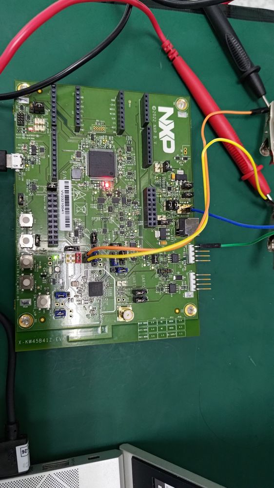

Hello NXP support,
I'm trying to measure Idd_LDO_Core via JP12 running example lowpower_peripheral (buck mode). Expect the current consumption in Deep sleep mode (when ADV is off) is few micro ampere. But actual the current is 2.6 mA

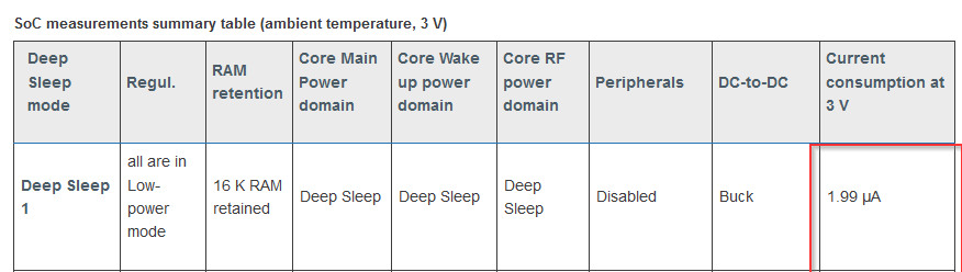

As I see, in the chapter "Report" the current in Deep sleep mode is 1.99 µA ,how to get that value?
https://docs.nxp.com/bundle/AN13230/page/topics/reports.html

I have some questions I perform some testing on an EVK and I see similar results that the ones presented on the document, there could be some variations.
But in this case I would like to know more information and I also have some observations:
  1. Have you modified something on the SDK example of lowpower_peripheral?
    1. If so please let me know in detail what changes.
  2. I understand you are currently using the buck mode configuration, can you please help me verify the following pins:
    1. JP5 3-4 This is for voltage is important to be at 3.6V.
    2. JP15 NC: Not Connected.
    3. JP11 in Open
    4. JP10 5-6
Can you please help me confirm this details I would really appreciated.
Also if you can help me with the device type you are using for this measuring it is also important.

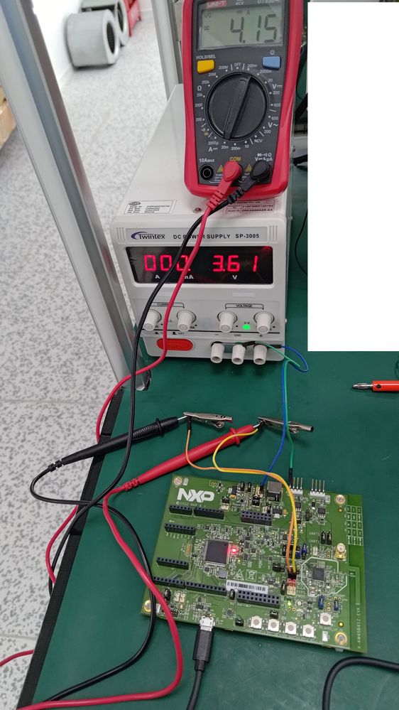

Could I now the current consumption values you measured through JP12 (LDO_CORE) when ADV was active/ not active?
Here is the information you requested:
1. No, I have not. I tried with the original example SDK 2.12.0 and SDK 2.12.7 but the same behavior.
2.
   a. Done
   b. Done
   c. Done
   d. Done

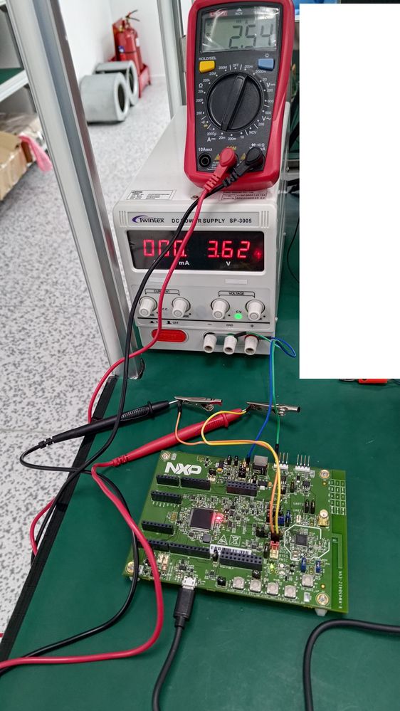

Current when BLE device name NXP_TEMP is present on BLE scaner application
Current when BLE device name NXP_TEMP is not present on BLE scaner application

I appreciate the information. The values you are currently receiving are compliant according to the Advertising Mode current consumption analysis, therefore this testing are performed with different tools and on a controlled environment, so the result might vary.
Please give a look into the chapter 5.2.2.4 Advertising Mode on the Table  16 that have the advertising current profile information.
Also can you please also help me by measuring the values obtained on the ldd_dcdc on the JP7: 1-2.
Please let me know your results.

Sure I have some feedback. In this case I do recommend to use another type of measurement tool as a multi meter is not the recommended tool to measure this type of current, so in this case I do recommend to use the recommended tools on the AN or use any other current probe or power analyzer.
Please let me know if there is anything else where I can help you.
5,216 次查看
BLEDev
Did you mean my measurement result is not reliable? Because this way of measurement is working for my old projects, I agree with you that I will can't see details about the current consumption between MCU and TX/RX states. But that are not the main parts in my requirement. As I sent you the picture when ADV is off and the current consumption of CORE JP12 is too high.
I expect to know how to get the result 1.99 uA (possible on JP7, but I can't get the same result) as the report summary?
