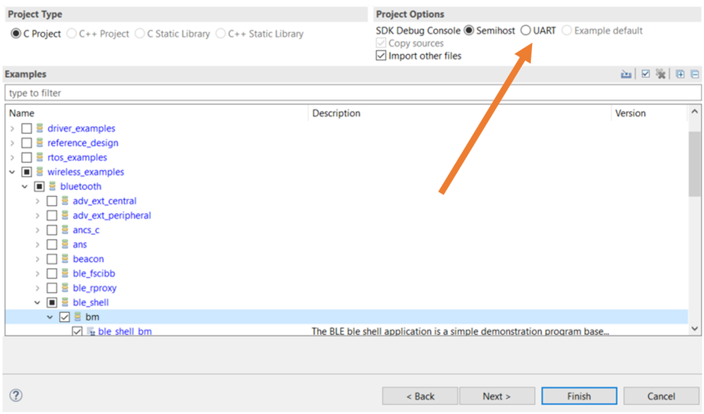

The FRDM-KW38 EVB OpenSDA Interface routes both SWD and UART to an USB interface, which makes the console printing possible using any of these interfaces as a source. If you exclude the OpenSDA Interface and use semihosting for printing data over SWD port, you may be able to see data by using a debug probe.
If your application is intended to print data in console (on your PC) you may need to implement an external UART to USB converter when using UART for serial printing. Also, if you are using a SDK example project, please note that UART should be selected in Project Options when importing the example:
Eduardo.

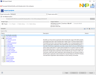

I import [ frdmkw38_hello_world ] project to test my board as basic test(pin config/clock config etc.....),and I'm sure I've chosen UART as Debug console when I import the project.

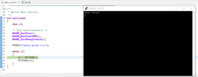

When I flash the Hello World project into my board,and reboot it,the putty didn't print out the word.
So I use my Multilink to get into Debug mode,and use [Step Over(F6)] then that it run over PRINTF function,and the [hello word] was printed out and display on Putty.
Normal, if everything is fine, I just flash the firmware into my board and reboot, it should print out data,but now it can print out only if it get into debug mode.
