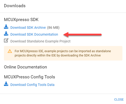

For more information, please refer to the Bluetooth Low Energy Demo Application User's Guide (inside KW36 SDK documentation folder > docs > wireless > Bluetooth).
