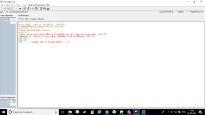

I want to use FlexNVM EEPROM functionality of KW36 & I'm trying the example in SDK "FlexNVM_EEPROM" for testing. However, the example does not seem to run on the go & I'm getting following error on debug -
There is no available EEprom (FlexNVM) on this Device by default.
I have not made any changes in the example code. I found that error is observed for flash_command_sequence function & further in that after following call is executed, I am getting flash access error.
callFlashRunCommand((FTFx_REG8_ACCESS_TYPE)(&FTFx->FSTAT));
Can you please help me with this issue.

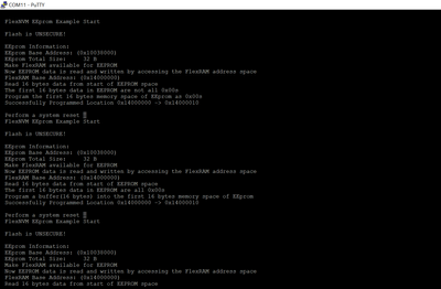

nxf56274
I test the sdk. It doesn't work. I refer the other mcu's eeprom finding that this sdk may has some problems. I modify the example. You can use the attachment to test. By the way, this program is built by mcuxpresso 11.3. I am not sure if it will work on 11.2. This is the result.

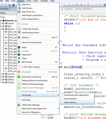

2,576 Views
nxf56274
Before you do this test, you should do full chip erase, or this may failed. I used IAR to erase the memory. You can have a try.  
TIC
