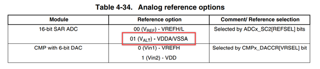

Now once again reading MKW36 Reference Manual, Chapter 4.8.1 Analog Reference options , i have some doubts.
1. I am using Valt as reference. From the document i can understand that VDDA/VSSA are now reference voltage because of Valt. But looking on schematics VDDA is VDD(3.3v) and VSSA is ground. Is it means my reference voltage is 3.3V?

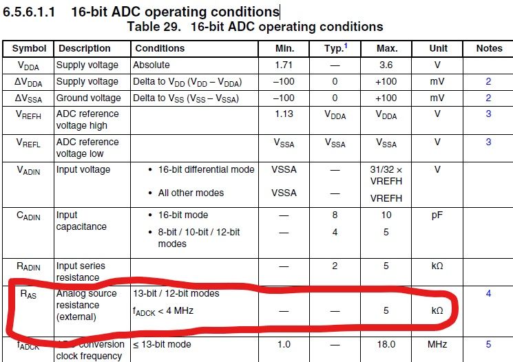

2. In KW36 data sheet, chapter 6.5.6.1.1 16-bit ADC operating conditionsScreenshot (32).jpg
So, i am using a 5, 1KΩ ± 5% resistors voltage divide circuit. When i am measuring the voltage across resistor from ground having 1V, the ADC gives 3564.  From the calculation it is 0.87V. But when i measured across 2V, 3V resistors i am getting 4095. If Valt is 3.3V then why i am getting 4095 on 2V and 3V resistors ?

What the data sheet is saying is that the ADC input must be driven with a source impedance of less than 5k Ohms.  Otherwise you'll just get crap.
Generally you'd take your resistive divider into a OpAmp follower.  The output of the OpAmp follower would drive a 51 Ohm (typically) resistor into a 33 pF (typically) Capacitor (pick its value to be slightly higher than what the internal input capacitance is to swamp it out).  This also forms a low pass filter to keep the internal switching from getting out of the chip.

Reference voltage will depend on the voltage supply. If your device is connected to 3.3V and you are using VALT as reference option, reference voltage should be 3.3V.

Does "internal ref voltage" mean that you are using the VALT (Alternate reference pin pair) as Voltage Reference Selection? Please, remember that VALT reference is routed to VDDA/VSSA, as indicated in the MKW36 Reference Manual, Chapter 4.8.1 Analog Reference options.
