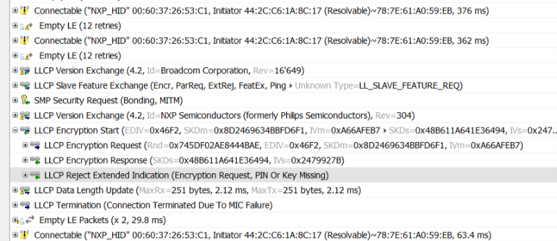

As you say ,i understand the "ATT_ERR_INSUFFICIENT_AUTHOR" is unrealizable, then what is the procedure in slave(KW36 peripheral) that can be done for making master(central device - iphone) to initiate a pairing request after slave has sent a security request in this half-paired scenario?
Also in your snapshot
Sai Kalyana Raman

xing_chang
Hi Sai,
When KW36 returns PIN or Key missing, the phone will initiate the re-pairing, but it is obvious that the iPhone has not done so.
Can you check if the iPhone receives a key missing message, if yes, you can actively delete the pairing message and repair it

skalyan2
Hi XingChang‌,
I have checked, iphone does not receive any "key missing message" , what is happening in my case is :
Step 1: KW36 is connected to iphone.
Step 2: I delete the bonding(keys) in kw36
Step 3: The iphone gets disconnected after step2 and after 2 seconds, iphone again shows as "connected" in "iphone->Settings-> bluetooth" menu , iphone encrypts the link and the iphone shows as connected . Can you please check in iphone X (12.4 ios version) and provide any workaround which can make iphone disconnect from kw36 or is it possible to do some workaround in "ios version - nxp iot toolbox" ? if any workaround can be done, please provide me the workaround , i am struck with this issue to test half paired scenarios
can you provide me some analysis for my request asap ?

xing_chang
Hi Sai,
At step 2, do you delete the bonding information using Gap_RemoveBond() in the connection state?
If yes, please disconnect first, then delete the bonding information.
Gap_RemoveBond
