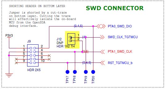

Has anyone had any luck converting a Freedom Development FRDM-KW41Z into a debugging system able to connect to a virgin uC?

BlackNight
Hi Frank,
do you mean like in Debug External Processors with USBDM and Freedom Board | MCU on Eclipse ?

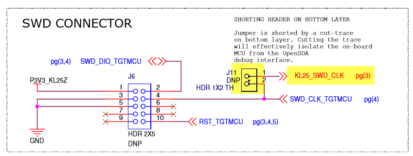

I don't think this is easily possible, because (on purpose?) the J12 jumper is isolating the OpenSDA from J9 on the FRDM-KW41Z:
This is *different* from other boards where the jmper is isolating the target CPU from the header (e.g. FRDM-KL25Z):
So on the FRDM-KW41Z board you would have to cut the line to the PTA1_SWD_CLK which is not that simple.

gerardo_rodriguez
A little late, but a detailed hardware workaround can be found at FRDM-KW41Z Development Platform Errata in the section 4) Incorrect routing of SWD clock for stand-alone debugger configuration. :smileyhappy:
