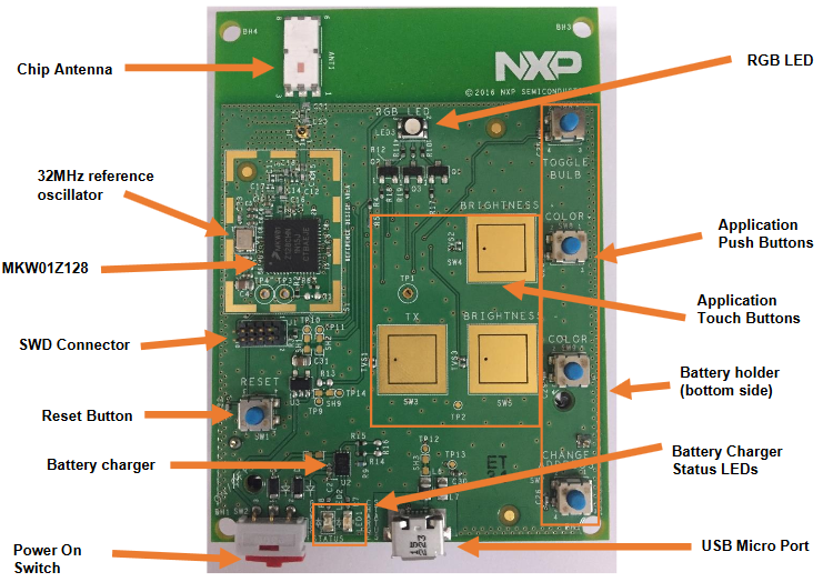

Overview
The Sub-GHz Remote Control Dimmer is a reference design which demonstrates the functionality of the MKW01Z128 MCU working in a custom IEEE 802.15.4 star network.
This reference design is focused on a home automation application where the user is able to control various RGB bulbs connected into a network using the KW01-RCD-RD board as a remote control. Controlled devices are USB-KW019032 boards, and each board simulates an RGB bulb in a GUI.
Sub-GHz technology has some advantages over other wireless technologies such less data traffic in its respective ISM band.
