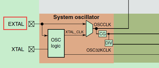

   I'm try to design RMII mode network with MKV58F1M0VLQ24,but i can't find RMII_REF_CLK Pin in datasheet.Can you tell me ,which pin is RMII_REF_CLK?

The RMII clock source can be EXTAL clock or ENET_1588_CLKIN selected via SIM_SOPT2[RMIISRC] selection.
So, the EXTAL pin or ENET_1588_CLKIN pin instead of RMII_REF_CLK pin's function.
Customer need consider to use EXTAL pin or ENET_1588_CLKIN pin.
