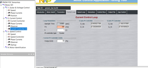

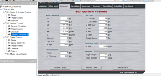

Hi ,
I am using TWR-KV58F220M and TWR-MC-LV3PH Tower System with Linix 45ZWN24-40 Motor.
I Am Facing issue with MCAT tool Tuning of Current Control ID, In MCAT tool as described in user manual i set Id_req :- 1A Iq_req:- 0.1A but in oscilloscope graph is not correct i think it is showing some garbage value. Graph and configuration details are mentioned below. Please also check if there is any issue in configuration parameter.

For the PMSM motor parameter tuning based on MCAT tools, pls refer to the an4642.pdf, which I attached.
Hope it can help you
