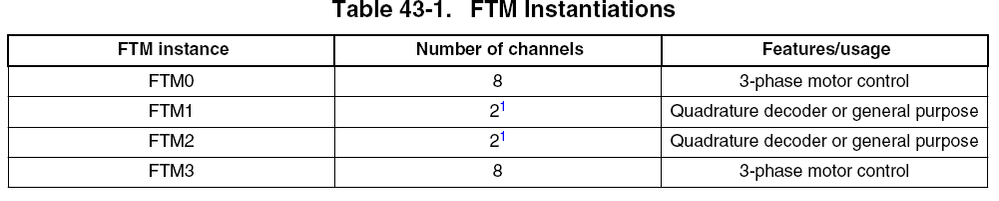

Can I use FlexTimer to do quad counting for encoder Phase A&B?
Or it is only supported by 2 channels FlexTimer?
Christie
8,533 Views
chris_brown
Hi Christie,
You can use the FlexTimer for Quad counting of a Phase A/B encoder.  But this functionality is supported by only the instances which have two channels.  In KV58F, this would be FTM1 and FTM2.  FTM0 and FTM3 have 8 channels and target motor control.
Chris
