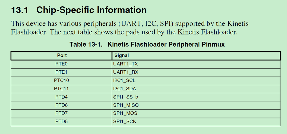

Document Number: KV31P100M120SF7RM rev.4 02/2016
Section 13.1: Kinetis Flashloader Chip-Specific Information
PTC10 and PTC11 are not available for I2C0.
PTD4 through PTD7 similarly not available for SPI0.
I imagine the port is correct and the signals are wrong.

Thank you for the info.
The correct Kinetis Flashloader Peripheral Pinmux should be:
I will report this document issue to Kinetis product team. Thanks again.
