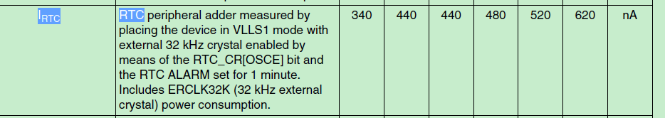

kerryzhou
Hi Carl Norman,
    What the low power mode you want to using?
   VLLS3, VLLS1 or VLLS0?
 From the reference manual Table 7-2. Module operation in low power modes, you can find the OSC can work in VLLS1/3 if the crystal is below 16Mhz, but VLLS0 is OFF.
RTC in VLLS0, the only clocking option is from RTC_CLKIN.
Please read the table at first, then decide which clock you can use.

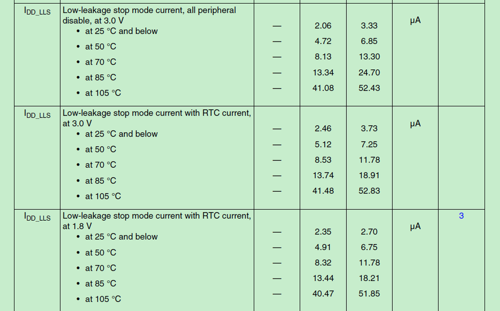

It does not matter if its more current, my target is 3uA per processor, but i can handle 10uA per processor really, (20uA total)...
I think I can run the KL03 in VLPS with LPO and use the LPTMR to wake up and get around 6uA? This wont require any reset logic to be handled, it can just stop and wake up and continue?
KL27 looks ok to run in LLS mode with RTC and external 32Khz xtal? Should be under 5uA?
This will take my total power to around 10uA which is fine, I can handle up to 20uA to meet the project requirements.

2. KL27 in LLS mode
Yes, it also can under 5uA.
You can use it, now the low power mode is determined on your side.
Wish it helps you!
