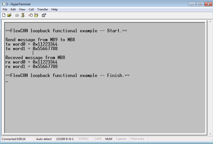

kerryzhou
Hi wf wf,
    Did you test it in the FRDM-K64 board with KSDK2.0-FRDM-K64 code which can be downloaded from this link:
Welcome to Kinetis Expert | Kinetis Expert
I have run the code :SDK_2.0_FRDM-K64F\boards\frdmk64f\driver_examples\flexcan\loopback  directly on my FRDM-K64 board, it works ok on my side.
flexcanConfig.enableLoopBack = true;
The test result is:
  KSDK2.0-FRDM-K64 is for FRDM-K64 board, this board is using the external 50Mhz clock, so please also check your board, whether it is caused by the clock configuration, or you also can use the external 50Mhz clock input to pin PTA18/EXTAL0
Kerry
