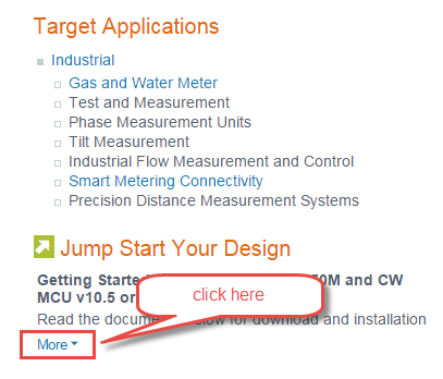

Hui_Ma
Hi Harish,
You could find a KM34 I2C example demo with [Kinetis M bare-metal drivers and software examples installation file] from below link:
https://www.freescale.com/webapp/Download?colCode=KMSWDRVAPIRM_SW&location=null&Parent_nodeId=134851...
If you could not open that link address, you could find below KM3x webpage and download that software from below picture indicated position:
KM3x |Kinetis KM3x LCD MCUs|Freescale|Freescale
Wish it helps.
