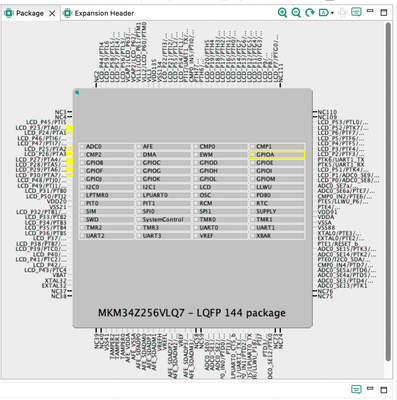

We want to use MKM34Z256VLL7 package and we are unable to use the SDK.
Could you help us to find how to change the package to 100 pin from 144 pin?

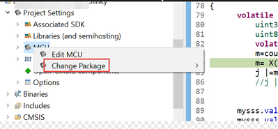

If you have a MCUXpresso based SDK project, you can change MCU package by right clicking on MCU -> Change Package.
