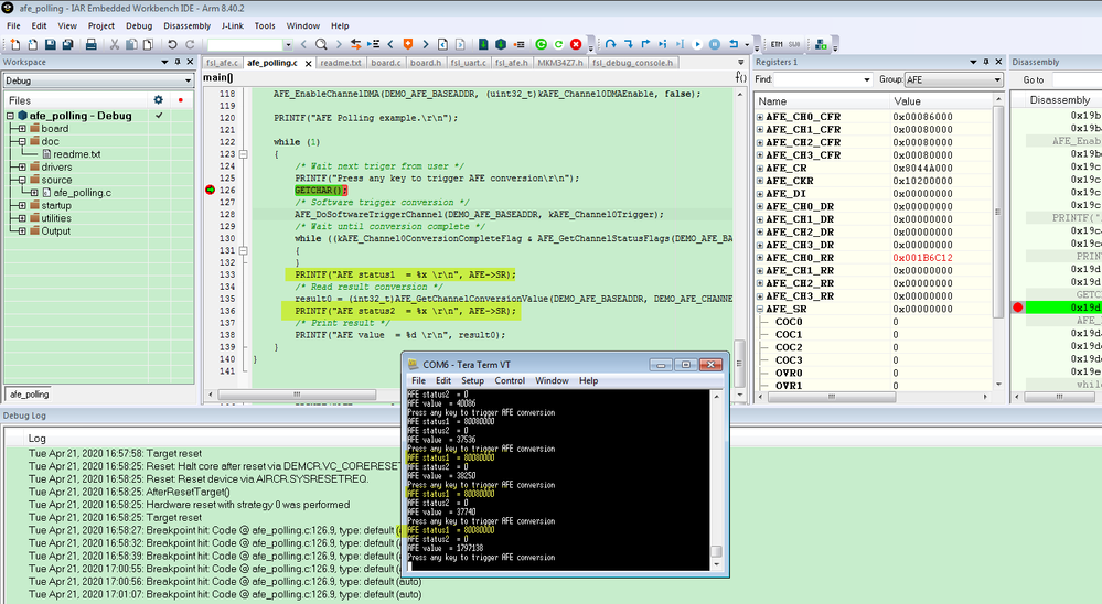

Using MKM34Z256VLL7. We use AFE modle, have error show as below. please suggest the reason.
The sdk version is SDK_2.2.0_MKM34Z256xxx7.
Or please help to give 24bit ADC example code for  MKM34Z256VLL7 AFE moulde.WeChat Image_20200420175933.png

   Seems after the get channelconversion value, the status is cleared.
    I printf the AFE_SR register, after trigger channel, and wait until conversion complete, you can find the COC00 and the RDY0 is 1.
I am testing SDK_2.2.0_MKM34Z256xxx7\boards\twrkm34z75m\driver_examples\afe\polling
 Do you also test the same project? What's the IDE you are using?
