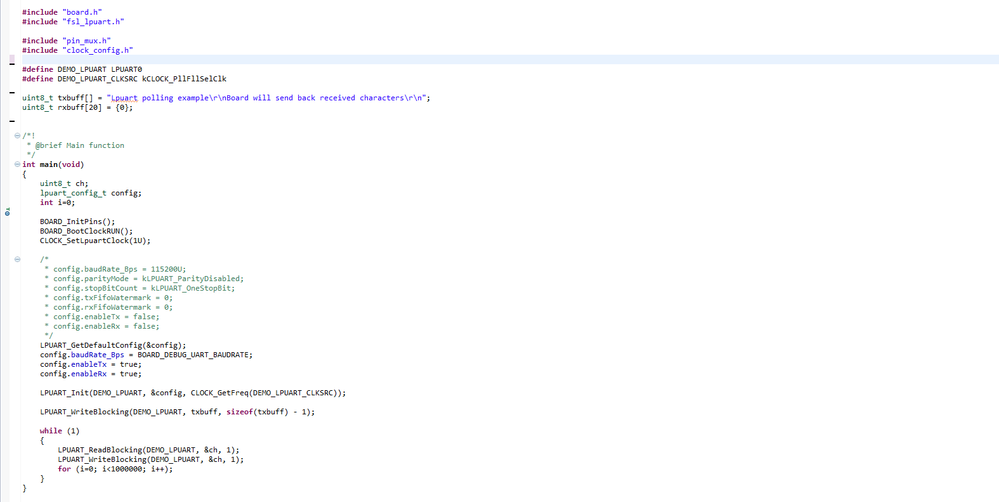

I created now two things:
I send a AT Command to UART via: LPUART_WriteBlocking(DEMO_LPUART, "AT\r\n", sizeof("AT\r\n")-1);
when I do the same with a function like this:
   void uart_esp12_send_command (char* esp_command)
                LPUART_WriteBlocking(DEMO_LPUART, esp_command, sizeof(esp_command)-1);
and then
uart_esp12_send_command ("AT-Command");
I only get with the function three letters displayed on the Serial Consol, but the normal Command ( LPUART_WriteBlocking(DEMO_LPUART, "AT\r\n", sizeof("AT\r\n")-1)) gives back the full entered string.
How can I change this? I need to change the data type.
How could I receive data strings with: LPUART_ReadBlocking(LPUART_Type *base, uint8_t *data, size_t length);??

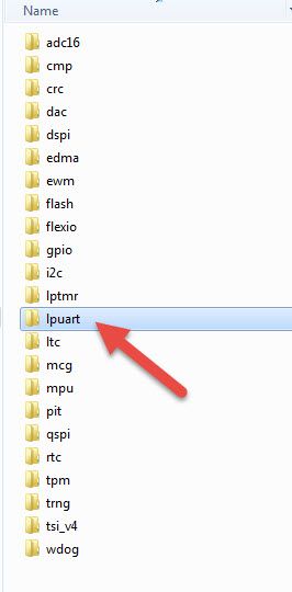

jeremyzhou
Hi Ulrich,
Thanks for your reply.
The LPUART demo resides in the \SDK_2.0_MKL82Z128xxx7\boards\frdmkl82z\driver_examples which as the Fig 1 shows.
Fig 1
Ping

us1
Thank you very much,
but I can't really understand this example, it's to hard to understand.
Is there some code for receiving strings?
Thank you a lot

us1
thank you for your kind help.
Well, I need to write and read string to/from the uart.
I can't see how I can write to the uart register. this would be interessting to know and which configurations are needed to get it working barebone. Or could you explain how I could use the functions from the libs?
thank you
