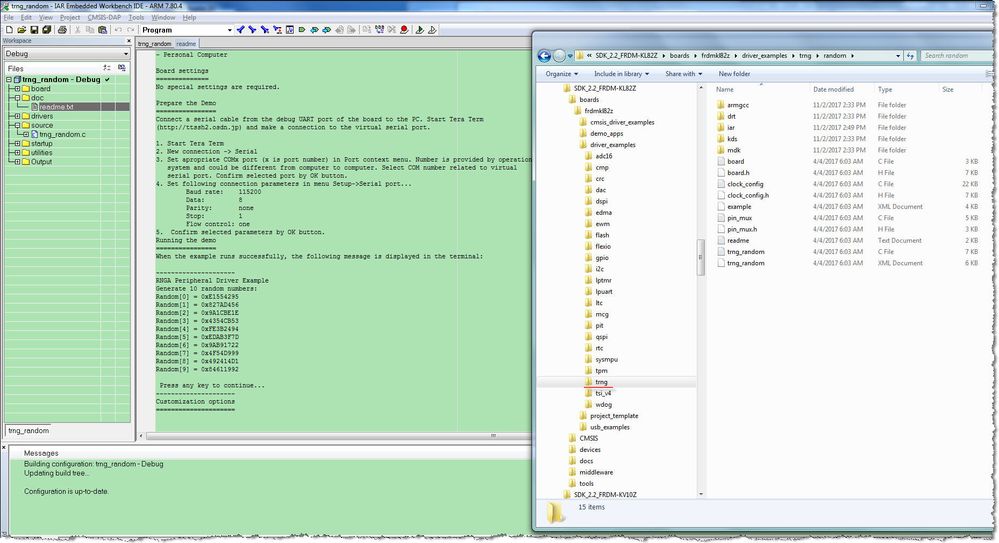

Have you try to refer the trng random example in SDK_2.2_FRDM-KL82Z?
You can download the SDK_2.2_FRDM-KL82Zpackage refer Generating a downloadable MCUXpresso SDK v.2 package.
And then the trng random example can be found in it's folder. (For example: C:\SDK_2.2_FRDM-KL82Z\boards\frdmkl82z\driver_examples\trng\random)

apikul
Thanks, I appreciate. Still getting used to using the SDK for proper implementation instead of the TRM.
