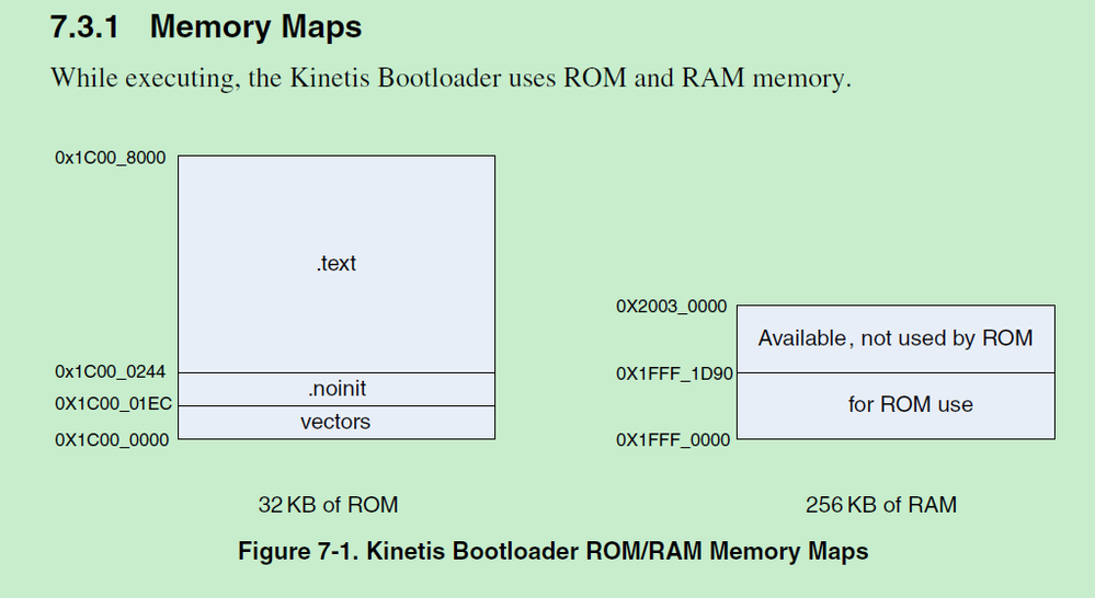

Also we'd like to know what RAM areas are the various bootloaders going to use?
In some applications values need preserved across restarts, which is hard to do if don't know what RAM the bootloaders will trash.

Hui_Ma
Hi Bob,
Please check below picture about KL82 ROM bootloader used RAM range:
Thank you for the attention.
Ma Hui
