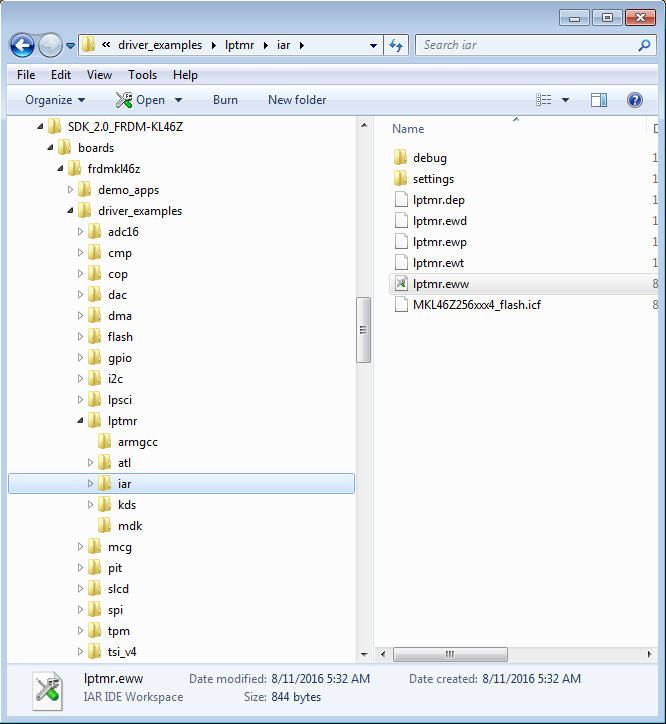

Please download the SDK_2.0_FRDM-KL46Z from this web.

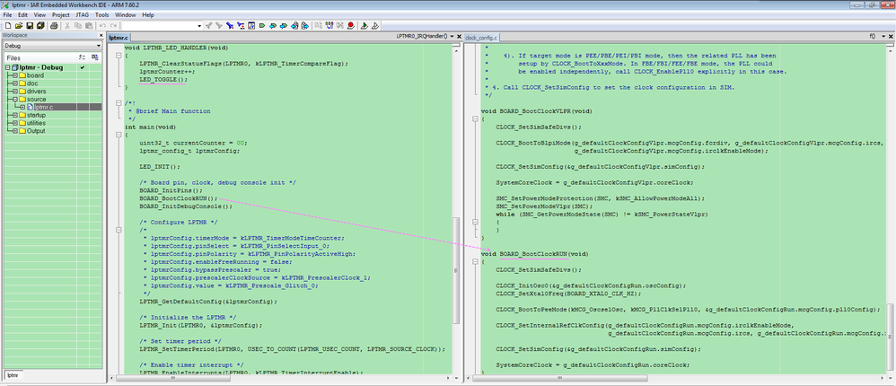

You can refer the lptmr project.
This demo toggle LED in LPTMR interrupt every one second.

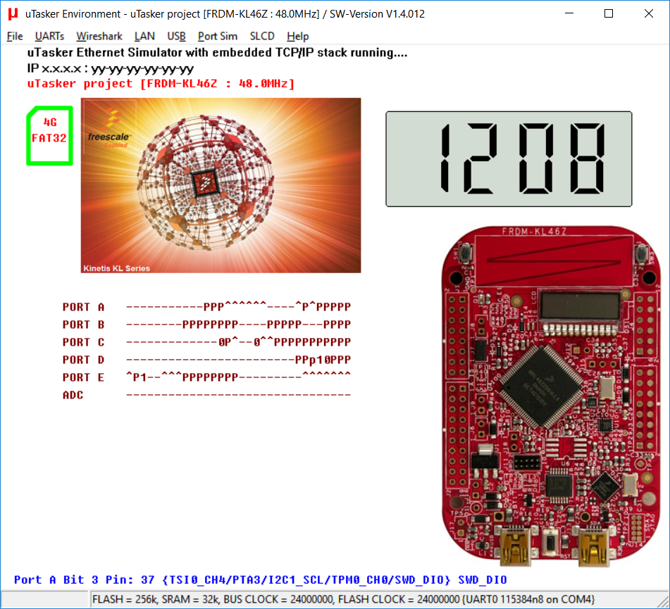

This is verified by the uTasker KL46 simulator below.

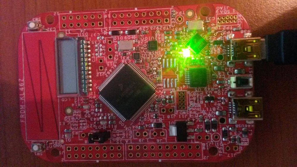

This is the board I  have:
Any other idea ?
Thank you,

The FRDM-K46Z requires high-gain crystal mode (MCG_C2 = 0x9c;)
If it still doesn't start, load the binary file from the link to the FRDM-KL46Z that I gave in the previous post to check that your board runs with it. Then either use the OpenSDA debugger or the memory debug command on its command line interface (VCOM at 19200 Baud, 1 stop, 8 bits, XON/XOFF) to display internal registers to see the values that are needed.

If you prefer an immediate and complete solution for the FRDM-KL46Z (with USB-MSD, USB-HID, USB-CDC, USB-RNDIS and TCP/IP, SLCD, File system, nRF24L01 and most other peripherals) simply download the uTasker project.
