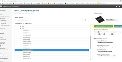

We are trying to run a USB code that was written for the KL27Z64V on the KL27Z128V and we are getting a hard fault since the memory map for both the controllers doesn't match. Hence we are looking for the memory map for the USB RAM for the KL27Z128V.
We already have the same for the KL27Z64V from Page 27 of this link: https://www.nxp.com/docs/en/data-sheet/KL27P64M48SF2.pdf
The USB RAM memory location is 0x400F_E000 for the KL27Z64V but what is it for the KL27Z128V is what we want to understand. Is there a document that you can direct us to?

kerryzhou
Hi neelshah,
  In fact, you have refered to the wrong SDK code, normally, to the KL27Z128 SDK code, you can download it directly, and it is based on the KL43 FRDM, please download the correct core again, you will know the detail USB_RAM usage:
https://mcuxpresso.nxp.com/
After you download it, you may find the project is based on the KL43 directly, but don't worry, you can change the related project drivers and startup files in this folder:
SDK_2.8.0_MKL27Z128xxx4\devices\MKL27Z4
All the drivers are listed. The USB drivers is the same stack.
Please try it on your side.
Wish it helps you!
kerry

kerryzhou
Hi neelshah,
KL27Z64V has the specific USB RAM, but KL27Z128V doesn't have the specific USB RAM, you may need to use the chip normal SRAM.
Wish it helps you!
Kerry
