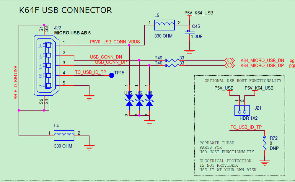

what are the connections between the USB on the K24 series and the USB connector - -
any resistors or  -
thanks

Hi James Pottebaum,
   You can refer to the FRDM-K64 schematic about the USB circuit.
The FRDM-K64 schematic download link is:
http://www.nxp.com/assets/downloads/data/en/schematics/FRDM-K64F-SCH-E4.pdf
Wish it helps you!
