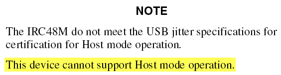

It's me again coming back to KL27 support for OTG. Sorry I need to make sure that i'm not overlooking the possibility of using the KL27 for OTG operation.
The KL27 datasheet (KL27P64M48SF6.pdf on page 42) says that  "The IRC48M do not meet the USB jitter specs for certification for Host mode operation".  I believe this is true only if the internal 48Mhz clock is used but it is capable of doing the OTG function with a dedicated external clock. Am I wrong? Could you please confirm on this for me?

Jorge_Gonzalez
Hi Devan:
Unfortunately your assumption is incorrect. In the same note you find this:
So it does not support Host mode, not to mention OTG.
The jitter is just a general note, because some devices (e.g. MK22FN512xxx12) have the IRC48M oscillator (crystal-less device mode) and also support USB OTG or Host.
