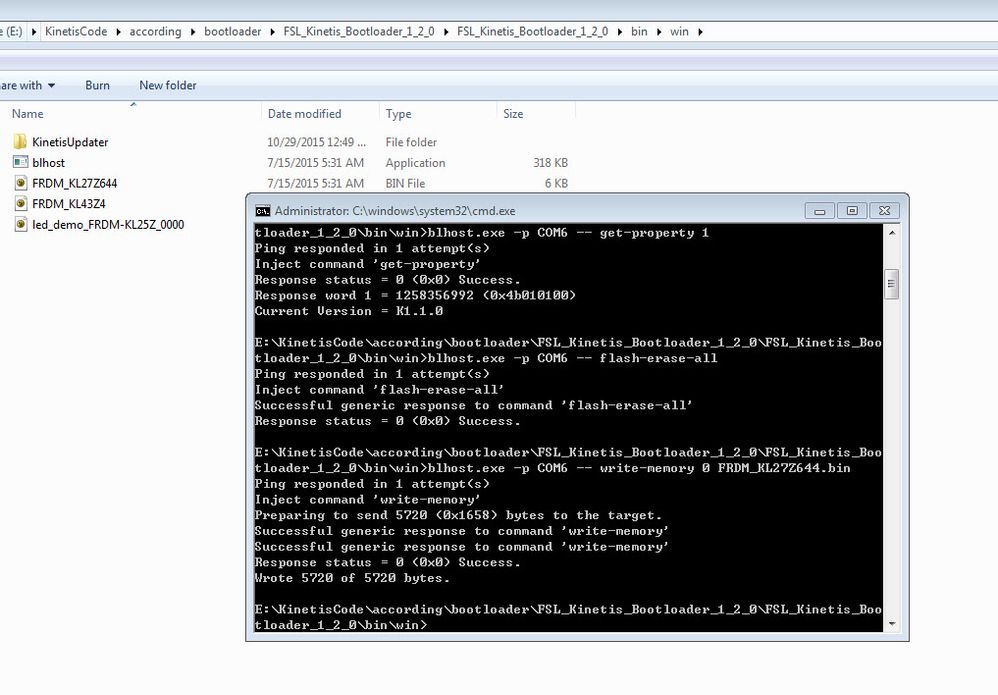

I have inherited a KL25Z design and I am looking into using the KL27 ROM part instead to make it so that we can download and update inside the product.  In looking through the 32 Pin version I see the UART0 can be brought out on many pins.
  • How do I find which UART pins the ROM boot loader initializes to?
  • Is there source code for the ROM or is the KL25Z bootloader source the same thing?
I have tried to get the FRDM-KL27Z to talk to the KinetisUpdater by holding down the NMI while resetting with no luck. From the KL25Z Bootloader 1.2.0 source below it appears as if the incorrect pins for ROM boot were selected in designing the FRDM-KL27Z.

Hi Donald Russ,
    KL27 have the UART ROM bootloader, so you don't need to use the flash bootloader which like the KL25.
    Please refer to the KBOOT 1.2.0​  document Getting Started with the Kinetis ROM Bootloader.pdf, which you can find in the folder:FSL_Kinetis_Bootloader_1_2_0\FSL_Kinetis_Bootloader_1_2_0\doc
  You can find the UART pins in the KL27 reference manual, chapter 13, kinetis ROM bootloader.
  KL27 is using PTA1, and PTA2 as the UART bootloader pin.
  You can try to use the blhost.exe in folder :FSL_Kinetis_Bootloader_1_2_0\FSL_Kinetis_Bootloader_1_2_0\bin\win
  This can download the application code to the KL27, the following is the successful download picture from my FRDM-KL27:
Wish it helps you!
