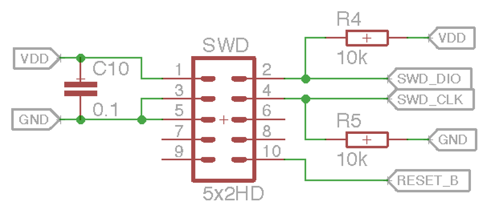

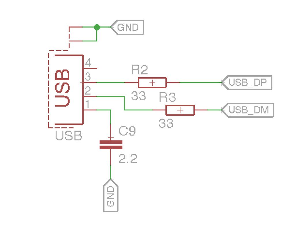

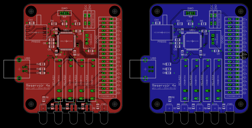

Can't get my Kinetis KL27 custom board to do anything.
No USB Enumeration / SWD (J-Link) detects secured device.
At POR RESETb gets pulled down internally after short strobe (~1ms). Could this be the watchdog in action?
Please let me guide you to my current setup.
Following some schematics. VDD = 3.3V.
Following the first Power-on, no USB-Enumeration happened. Examining closer the isolated MCU consumes 3mA @ 3.3V. Strangely RESETb is pulled low. As is the J-Link probes orange LED indicating.

kerryzhou
Hi Buca Zeug,
    Please do some modification to your board:
    1. Reset pin, Add 4.7K to 10K pullup resistor in the reset pin, and connect 0.1 uf capacitor to ground.
    2, NMI pin, add 4.7K to 10K pullup resistor.
  To a new chip, the Reset have the sawtooth wave is correct, after the chip is programmed, the reset pin will be pulled up.
  After you modify the board, use the JLINK COMMANDER to check whether it can dedicate the ARM core M0+.
  Besides, what the solder temperature when you soldering your chip to the board? From the datasheet, the solder temperature should below than 260 °C
Wish it helps you!
