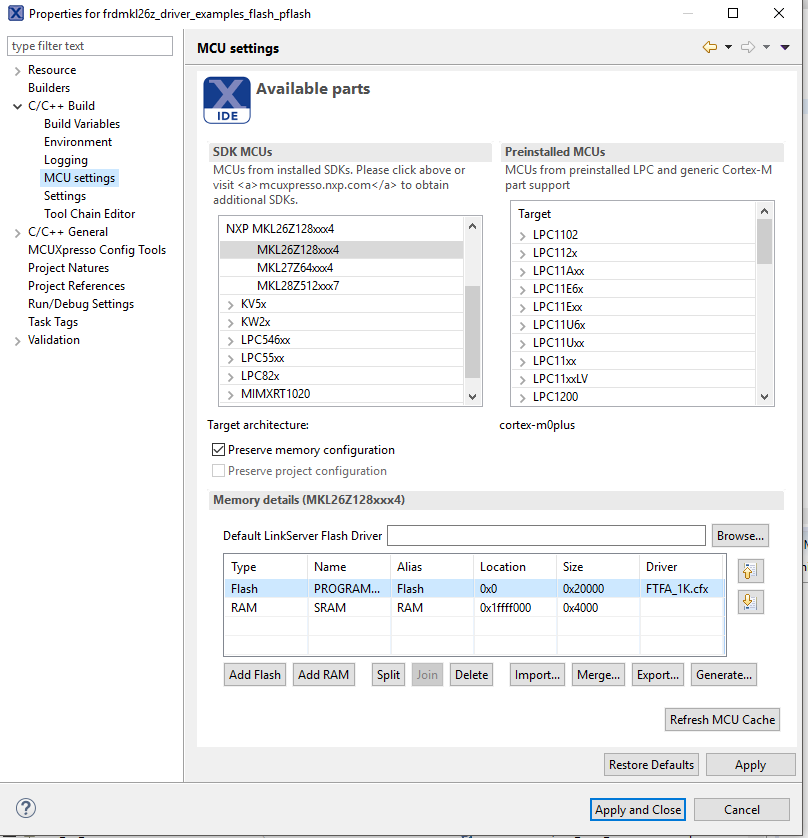

I would like to store run-time configuration information in the MCU's internal FLASH.
The FLASH will be written to less then 10 times for the life of the product.
In other MCUs, I could define a section in the FLASH that the linker and compiler would then reserve.
Can I set up a FLASH area in MCUXpresso, or do I have to bit bang this all out?
Bruce Graham
Tags (2)
2,431 Views
diego_charles
Hello, Bruce

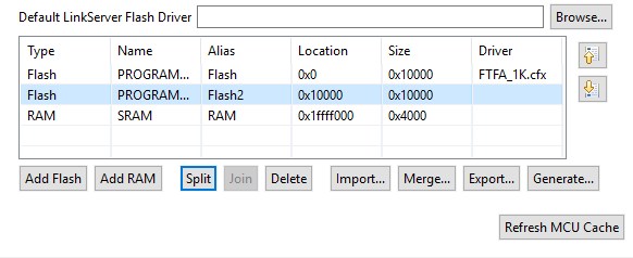

In the MCUxpresso you could add and split flash areas by doing a right-click on the project, then click on properties.
After doing a split for example you could  specify the amount of space and then apply and close
I hope this information helps you. If you need more assistance please let us know!
Best regards, Charles
2,431 Views
bgraham
Diego,
You created a FLASH "area" that is named "Flash2".
How do the SDK FLASH APIs use the new FLASH "area" that is named "Flash2"?
Bruce

bgraham
Thanks Diego,
but the FLASH can't be written to from code running from FLASH, so must run from SRAM.
I am using the KL26 SDK with my KL16 MCU.
I defined a APP_FLASH_1KB in Properties | C/C++ Build | MCU settings.
address=0x0003FC00, size=0x400
In the debugger's memory window, I can see the top of FLASH at 0x0003FC00.
0x0003FC00 to 0x00040000 is filled with 0xFF.
I used the debugger's memory window to set 0x01020304 at 0x0003FC00.
0x0003FC00 01020304 FFFFFFFF FFFFFFFF FFFFFFFF ....ÿÿÿÿÿÿÿÿÿÿÿÿ
0x0003FC10 FFFFFFFF FFFFFFFF FFFFFFFF FFFFFFFF ÿÿÿÿÿÿÿÿÿÿÿÿÿÿÿÿ
memcpy() from 0x0003FC00 returns 0x01020304, so the memcpy() worked.
memcpy() to 0x0003FC00, generates a Hard Fault, IPSR = 0x3.
The buffer used by memcpy() is aligned on the 32-bit address 0x1ffffc40, so I doubt the Hard Fault was caused by an alignment fault.
