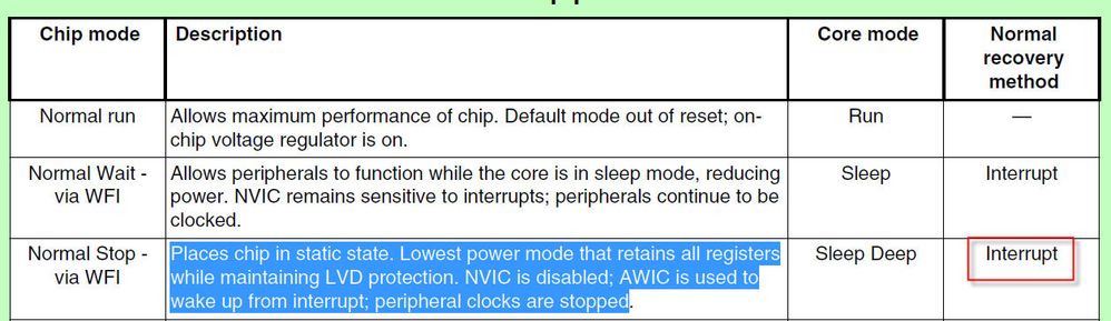

gibbon1
I had to deal with this and know why it's confusing. There are two wake up interrupt sources on the KL24, the AWIC and LLWU.  The AWIC is part of the standard ARM core from Arm Ltd.  The documentation is mostly on the ARM website. The LLWU is a Kinetis (Freescale) designed module and is documented in the KL24 data sheet.
Very simply,
The LLWU is disabled except when in a Low Leakage Stop Mode. Which means it cannot be used to wake the processor up from normal stop or standby modes. You need to use the AWIC instead.
The AWIC is disables in Low Leakage Stop Modes, which means you need to use the LLWU to wake up the processor from LLS.
Note on the KL15 which I'm using some LLWU input pins also have pin change interrupts (AWIC) and some do not.  This can be an issue if you want a pin to be able to both wake up the processor from sleep mode and low leakage sleep mode.  If possible you may want to avoid using the low leakage stop modes unless you really need ultra low sleep current.

kerryzhou
Hi Amreen,
   According to our reference manual, if you want to come out of normal stop mode, you should use the interrupt.
   Just like the following:
So, I have a question, did you configure the PTD6 interruption?
Best regards!
