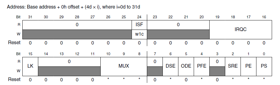

mjbcswitzerland
Specialist V
Dan
You have equates for PORTA_PCR2 etc. but haven't used them yet.
You need to configure the pin mux setting in these registers otherwise they are still in their default condition:
- PTA2 is disabled
- PTA4 is NMI input
- PTA5 is disabled
Write the MUX setting of each to 0x01 (ALT0, which is the GPIO setting) and then they will start operating as ports.

mjbcswitzerland
Specialist V
Dan
You need to first read the data sheet before writing values to registers:
The MUX setting for GPIO is (0x01 << 8) [or 0x00000100] and not 0x01. There are also settings for drive strength, speed although these can be left at 0 for your case. Your code was just selecting a pull-up resistor on the pin.
You can write the register whenever you ant to change the setting (including setting back to its origianal configuration).
Mark
