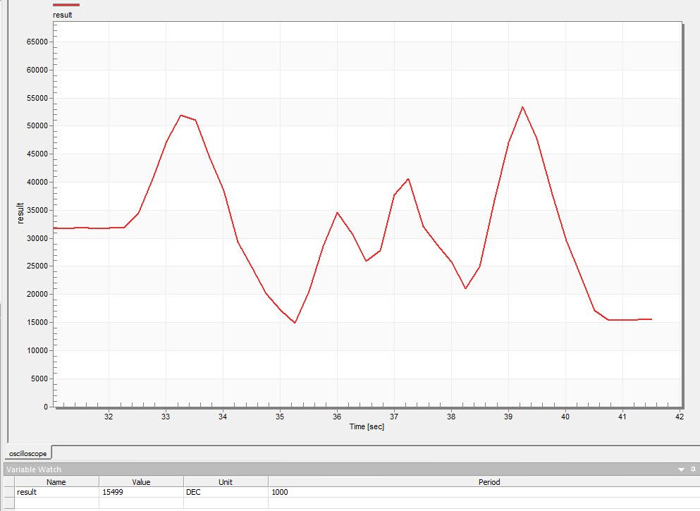

hoemin
Dear all,
I had completed the project in July 2016 by switching from KTY 82/100 to LMA75A Temperature Sensor.
Best Regards
Hoe Min

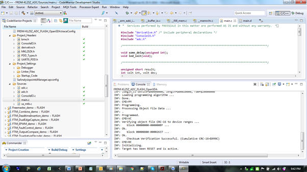

hoemin
Dear David,
Thanks for your advice.
I had purchased the KTY82/100 Temperature Sensor and wired up to use with FRDM-KL25Z ( MKL25Z128VLK4). I had run your program using main.c, see screen shot below:
but it did not show any readings. I need to display in "real-time" the readings in degree C on my laptop screen, export to Excel .csv file to display on Excel or using a external program to grab the data and display on screen.
I will be grateful if you could help and enlighten me on this.
Thanks and Best Regards
Hoe Min

david_diaz
Hello Min,
I am glad to help.
The project that I provided you before, measures the bandgap voltage reference.
You may find attached an even simpler ADC project in order to measure the temperature sensor output.
Please note that PTB0 is the analog input.
The complete source code is written in the Kinetis Design Studio v3.2.0 in collaboration with the FreeMASTER tool in order to visualize the magnetic data.
In case you still have problems to read the temperature sensor, please provide your schematic.
I hope this information will be useful for you.
If I misunderstood your question, feel free to let me know.  I will be glad to help.
Have a great day.
David Diaz.

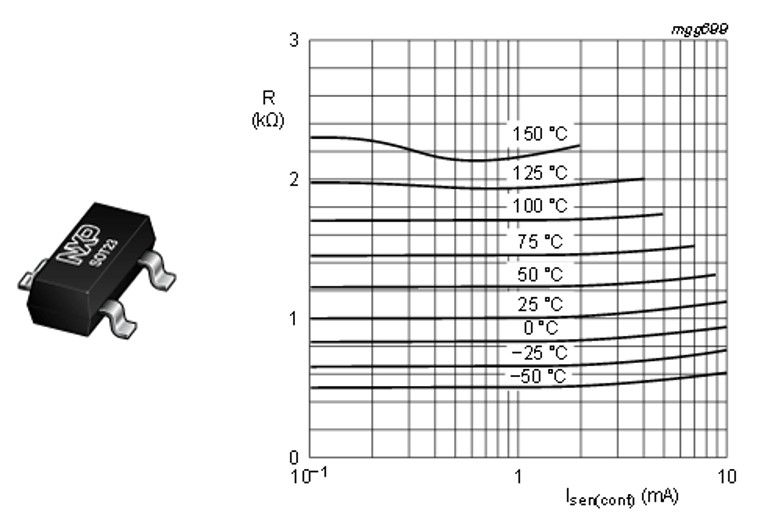

david_diaz
Hello Hoe Min,
Based on your requirements, a suitable recommendation would be the KTY82 series.
The temperature sensors in the KTY82 series have a positive temperature coefficient of resistance and are suitable for use in measurement and control systems. The sensors are encapsulated in the small plastic Surface Mounted Device (SMD) SOT23 package.
The temperatures sensors in the KTY82 series can accurately measure temperature from -55C to +150C.
Some of its features are:
  • High accuracy and reliability
  • Long-term stability
  • Positive temperature coefficient; fail-safe behavior
  • Virtually linear characteristics
Please find more information about the KTY82 series as well as its datasheet at the following link:
http://www.nxp.com/products/sensors/temperature-sensors/silicon-temperature-sensors:KTY82
In regard with the project source requested, please review the file attached.
The file contains an FRDM-KL25Z ADC Project for CodeWarrior v10.x with its corresponding presentation.
Have a great day.
David Diaz.
