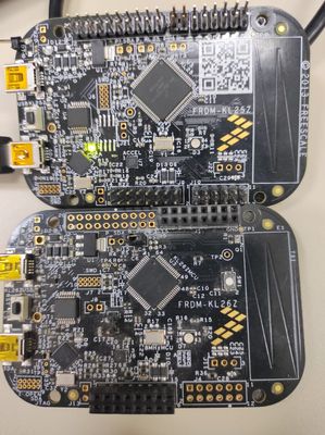

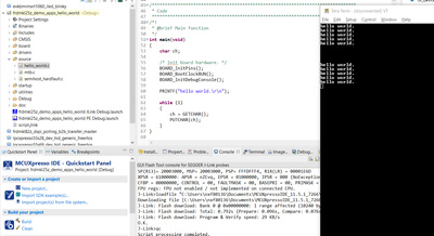

After the test, the results were the expected ones. You can flash the same .bin or .axf to both of them. I made the test compiling a KL25 hello world example and then I connected the KL26 and I flashed it with the same program.
I will attach some pictures for evidence:
