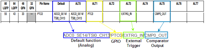

Unfortunately there is no such document which list the pin assignments as Processor Expert does, but is easy to understand with some help from the Reference Manual.
All the pins are by default in its analog configuration, this for high impedance. All of them can be configured as different signals, e.g:
Thus this Pin can be configured as an ADC channel or a Touch Sensing channel or GPIO or External Trigger or Comparator Output. All the pins have their GPIO function in ALT1 it means that in PEx format will be the second or the third; and the first will be its analog configuration, in this case it is ADC channel 14.

In the Quick Start Package ( http://cache.freescale.com/files/32bit/software/board_support_packages/FRDM-KL25Z_QSP.zip?fpsp=1) you can find the FRDM-KL25Z Pinouts document which list all the pins for KL25 with their functions.
Or you can try with the KL25 Sub-Family Reference Manual ( http://cache.freescale.com/files/32bit/doc/ref_manual/KL25P80M48SF0RM.pdf?fsrch=1&WT_TYPE=Reference%... ) in section 10.3.1 KL25 Signal Multiplexing and Pin Assignments. there is listed all the functions for each pin.
