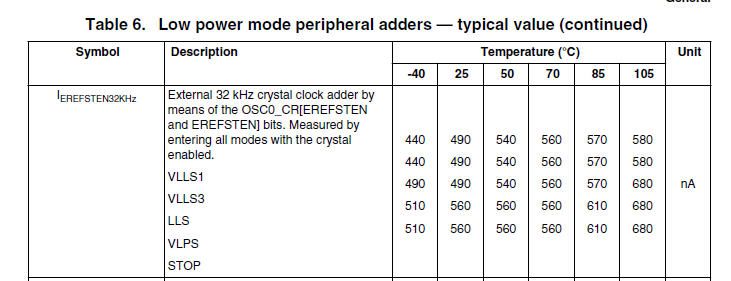

2> When the chip in VLLSx low power mode, system oscillator is limited to low range in VLLS1/3 and Off in VLLS0. And RTC module still works in Async operation (in VLLS0 low power mode, the RTC clock source from RTC_CLKIN pin).
If you check the 300nA in VLLS0 low power mode, which does not include RTC external clock source power consumption.
The datasheet shows the Table 6. Low power mode peripheral adders — typical value about external clock source add power consumption.
3> Kinetis L RTC module can only get power form uC main power. The Kinetis K series product provide VBAT pin to provide sperated power to RTC module.
