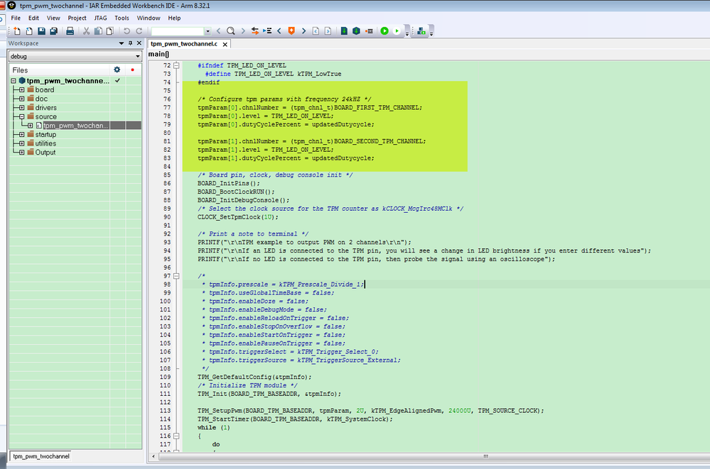

kerryzhou
Hi BOB KOHAN,
      I highly recommend you use our newest SDK2.x instead of the SDK 1.3.0, that is really very old and not updated even it has bugs.
     Please download the SDK2.x from this link:
      https://mcuxpresso.nxp.com/en/select
   In the processor choose your MKL17z32 part number, than generate the code and download it.
  You can refer to the project tpm_pwm_twochannel in folder:SDK_2.4.1_FRDM-KL27Z\boards\frdmkl27z\driver_examples\tpm\pwm_twochannel
Then you can refer to this code, just add another channel.
Wish it helps you!
Kerry
